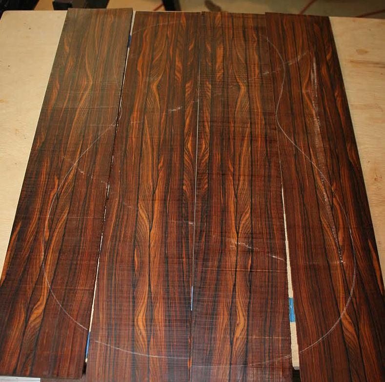

PostPosted: Mon Dec 11, 2006 12:38 am
Here are a few shots of a four piece cocobolo 0-12 im making.
PostPosted: Mon Dec 11, 2006 5:01 am
Posts: 655
Location: Columbus,Ohio
WOW! That is pretty Lance. I see you brace as normal. Thanks for sharing. Clinton
